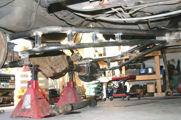

I just put this under my car, and so far it works good. We'll see how it does in Moab in a few days.
It won't win any RTI competitions, but oh well. I have a few more degrees I could get out of it but I set my bump stops and limiting chains to keep the 2.5" flex joint alive.

What kind of joint are you using for the link and are you using a pan hardhard bar for side to side?

Thanks for the kind words, and I appreciate yor interest in the car. I am very excited to finally have it done (well mostly done). I ordered the joints from M.O.R.E after seeing them at the vendor show at the Jeep Safari in Moab last year. I beleive Daystar makes them. It's just your run of the mill flex joint I think. I bought 3 of them and have them welded into a piece of receiver tubing. That way if I break one I just slide in a new one. Yes it does have a panhard/track bar to kep it laterally stable. Heres another pic of it.
