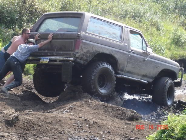

Does anyone run the 3/4 ton ford ttb front end with tires they shouldn't? Heres mine, Been runnin this setup now for 2 summers, only broke 1 axle (U-joint actually) so far, but no other probs. Anyones input? I mostly hear that I am apart of some kind of exception, but this is the second truck i've run with this front end without issue..... comments?

I really like your Ford! That bed is my style!:drive:
